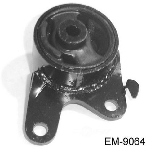

It looks like I have the GT bracket on my LX ( ? ) it looks like this http://images.whisystems.com/smartpages/partinfo_resize/WSR/EM-9064.jpg?width=300&height=300 AND on the side of the mount there is another bracket that connects to the bolt that goes through the rubber bushing, and to the side of the transmission.
Does anyone else with a F2 (N/A) have this style of mount?

Very similar to the GT only the threaded back is part of the mount.

That's pretty much what I have, on my LX - complete with the third bolt hole on the side. Right now only one is holding on and it's not pretty.

As far as fitment, they are interchangeable...I think the GT's are a bit stiffer...there are only 2 bolts on any of them, then the long bolt through the rubber...so if it broke 2 bolts, none are really holding it...I have some n/a mounts that are a 1 piece like that and others that are 2 piece, I thought the GT's did the same thing, but maybe not...size and bolt pattern the GT and V6 mounts are the same, but the v6 mounts have less meat in them...

hey, so I just realized something...I was think wrong LX...your mount is different than a GT, but ANY n/a mount will work there (at least manual) just different years had them as 2 piece or 1 piece...my bad...I did start in probes, though, and automatically think v6 for LX
I've been able to find the mount you need at both autozone website and rockauto...anchor part number 8462 at rockauto
