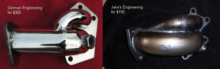

Yes, Sam and I sat down at the PC connected to his flange cutting CNC machine (he has 3) and spent a few hours futzing with the originally designed flange, which, incidentally, was the FIRST flange he ever designed (the IHI-RHB5-VJ11). Then we modded it a couple more times, eventually adding in a notch for the wastegate hinge (because I was paranoid it might hit) and a notch for the little fence that is welded on to protrude into the turbine housing.
Then James (his son) spent the rest of Saturday evening, and some Sunday morning to come up with what you guys saw. We had to mod it a bit to get a nut on by dimpling the tube a bit, but it doesnt affect flow as the actual hole in the flange is matched to the size of the turbine housing outlet which is smaller than 2.5 inches.
BTW, it was all tig welded.

Lets compare the German o2 housing on eBay to mine
Their version:
chrome?
smaller primary tube
wastegate tube at 90 degree angle
thin flanges
far too expensive
shipped from Germany
My version:
Big primary tube
Wastegate tube is collected and a very sharp angle down
no ghetto chrome
cnc lathed flange to match the turbine housing exactly
cheaper
Made in the USA and shipped from Texas.
I think this picture says it all (other than I can't take very good pics, heh)
