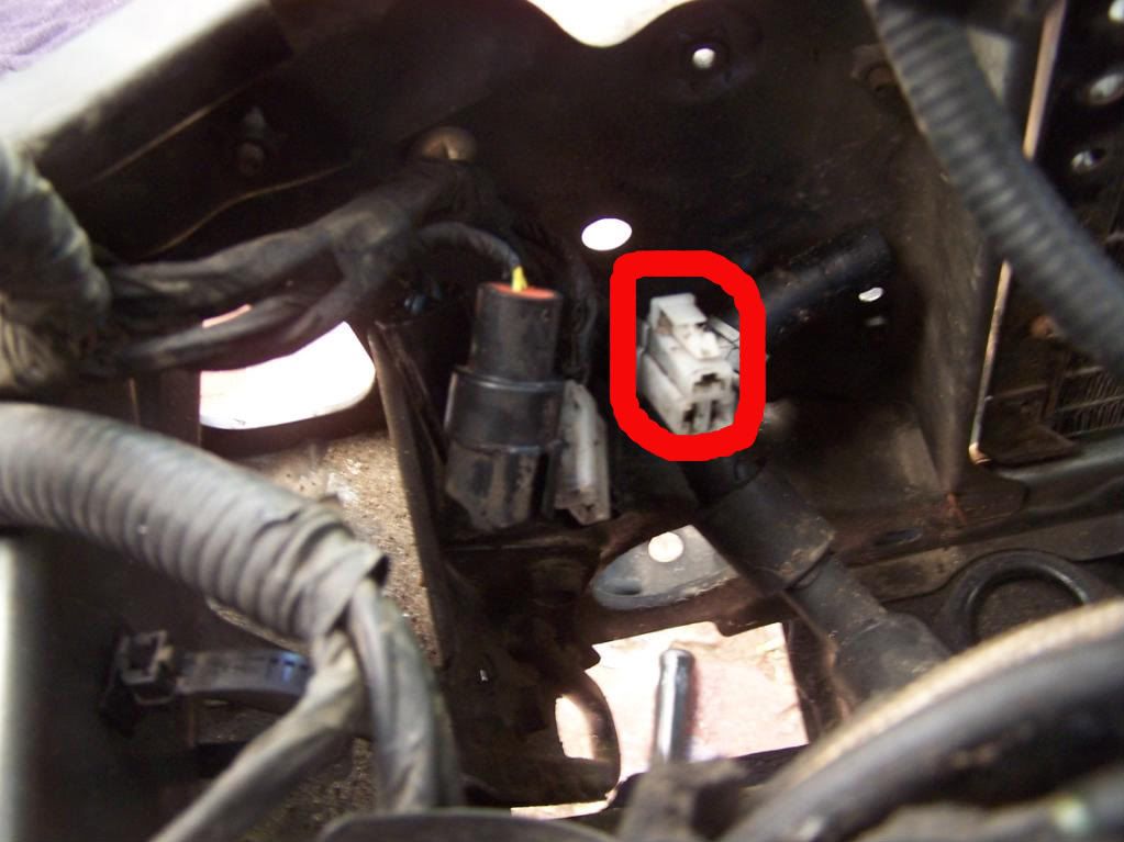

i didnt rewire anything and neither do i change it. you dont have to. bypass the inhi switch and run a jumper to the other harness below the battery tray and you are done. why will you change the instrumental cluster?. not needed. also you dont have to change the ecu. the stock auto ecu works great .

what wire do i need to bridge to bypass the inhibitor switch?
Underneath your engine bay fuse box, there is four plugs for the auto. You need to bridge the two large wires on this plug.
The third wire on this plug is for your reverse lights, just wire up a 12v ign source to one side of the reverse switch on the gearbox, and the other side to this wire.

Depending on what you did with the harness that went to the shifter mechanism, there was a switch there that will only allow you to start the car in park or neutral.
there are two. one for the light and the other is jumpered.
It's called the inhibitor switch...I hope I didn't botch that. I'm finishing up my install with a swap as well lol
