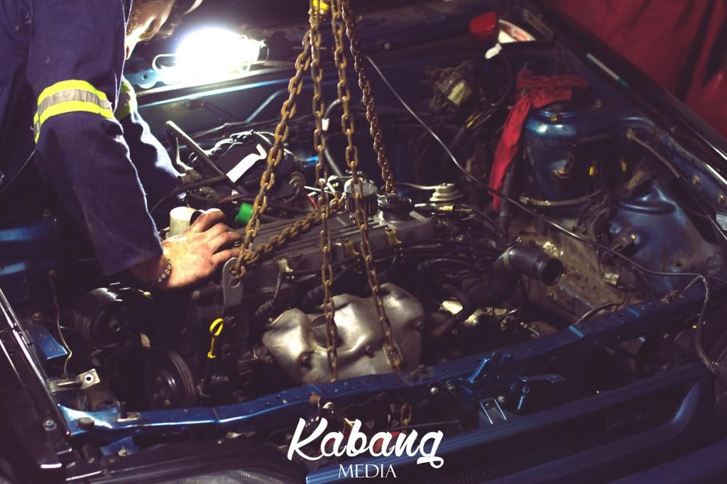

Removing the B3
And here lies a legendary, bulletproof motor. Thank you for everything little B3

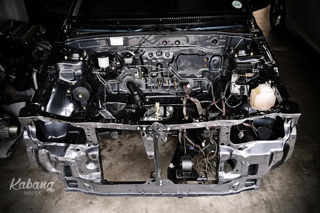

I sanded the bay by hand
Chose a colour for the bay (R32 grey gun metallic)
Prime
Bay complete. Hardware was electroplated gold and everything fitted
