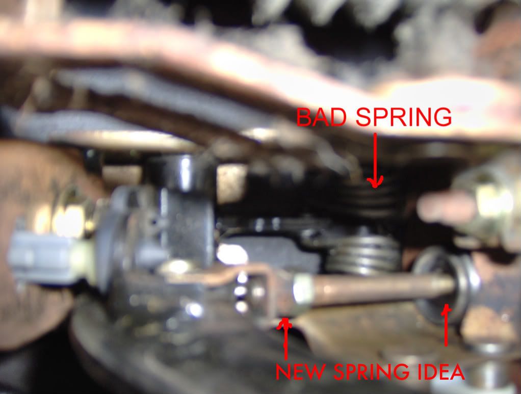

Ok I have replaced my clutch master and slave cylinder(last year) as well as a new clutch. I have been driving on the clutch for about a month and I have been having trouble with it slipping when shift quicker and attempt to accelerate quicker. I have a ze with about all the bolt ons, but even with all that I don't think this exceeds the capability of the oem clutch, even paired with the 11lb flywheel. I noticed yesterday that my clutch pedal wasn't coming completely up when I pushed the clutch all the way to the floor, but if I would lightly start to push on the accelerator and then pull the clutch pedal the rest of the way up with my foot it would grip all of a sudden(thus I spun coming out of Arby's yesterday). I had the rod on the clutch pedal adjusted all the way out before so last night I readjusted it so the master cylinder wasn't pushed as far as the pedal could go hoping this would fix the problem, but it didn't although it is somewhat better(this could also be attributed to me knowing not to completely push in the pedal). Is it possible that the spring on the clutch pedal needs replaced? If pulling the pedal up helps to engage the clutch it would seem this would help? Any ideas?

I laid on my back under the dash for quite some time last night pushing the pedal all the way down and then gently letting it out. I noticed that the goofy ass spring that is connected to the top of the clutch pedal is completely wore out and is actually kind of putting a bind on the plunger in the center of the master cylinder. The plunger stops about 1/8" from coming against the c-clip and fully allowing the clutch to engage. When I would push in the pedal and quickly pull it back the plunger would come completely out with no problems.
I'm thinking about going to the local hardware store today and getting a regular spring and a couple of washers and seeing if I can rig something up between the pedal and cylinder around the rod that pushes the plunger. If that makes any sense.

You've gotta love these old cars...glad you figured it out bro!
Personally, I would replace it with the same spring. Your idea sounds good in theory, but, if you have luck like mine Murphy's Law is the only theory I live by! lol
That could probably work, but I would say to stick with a stock solution too. I'm sure these springs don't go bad too often, so you can probably pick one up from a wreckyard that will last you the life of the car.
It would probably be hard to find a spring that compresses at a rate that feels 'right' and it would make it impossible to diagnose a clutch system leak because the pedal would always return all the way up no matter what.
I may try my idea as a band aid until I can make it to the junkyard, or I may even see if the dealership can get it. I wouldn't think that the spring would be expensive.
