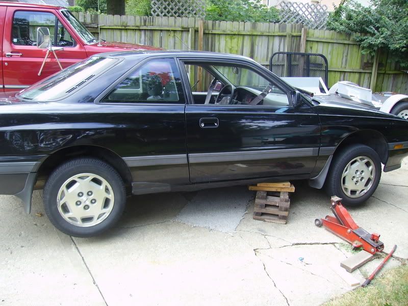

Car jacked up and settled on my gangsta jack stands. They may look unsafe but they have held a Ford F 350, and have been going strong for YEARS.

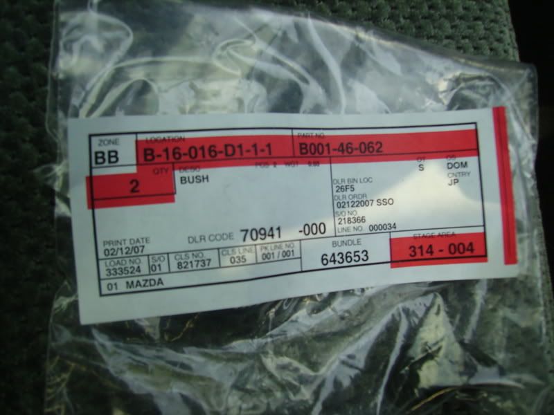

The parts, yep, my bushings are JDM tyte y0!

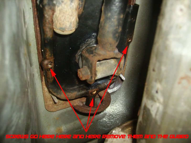

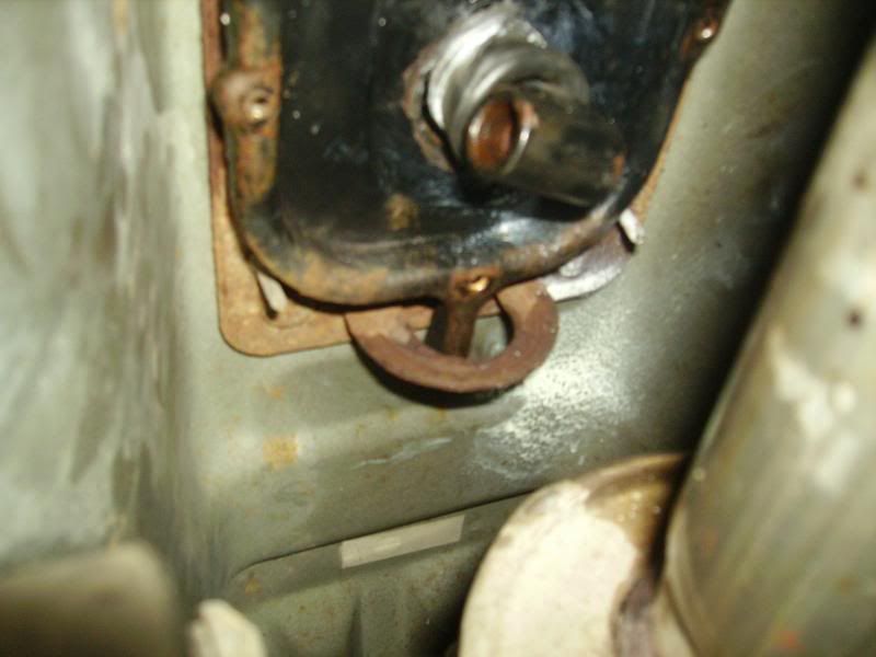

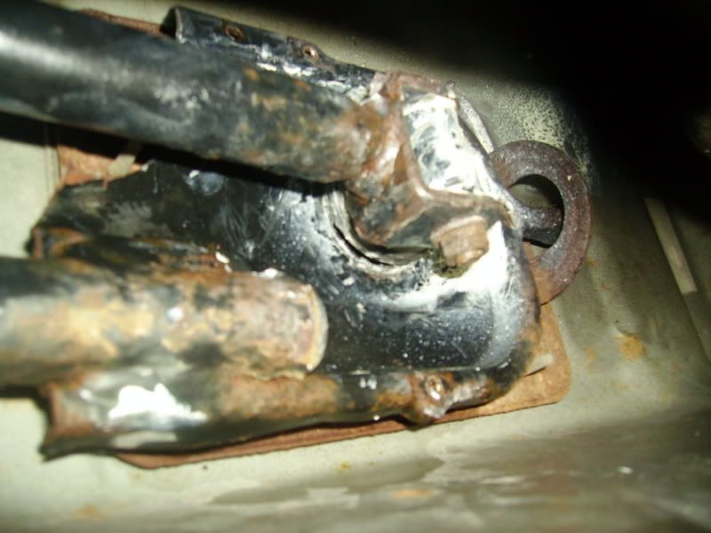

The rear culprit, this is with the cover removed
Get a wrench on one side and a ratchet on the other and break it free. This can be tricky, i had mine soaked in PB Blaster, and made fairly quick work of it, the shifter can tend to move around, so put it in gear to make the job a little easier.
then pop the screw out, i had to twist mine a decent amount but it came
Drop off the shift linkage

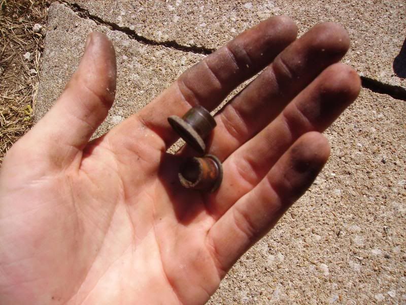

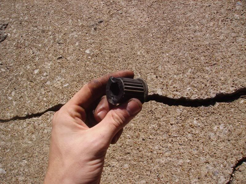

Remove the old bushings, one of mine pretty much crumbled, one came out fairly easy. I used my small flathead to get the one out.
Grease the new bushings and reinstall everything, here it is put back together and greased up, kind of messy but i don't care.

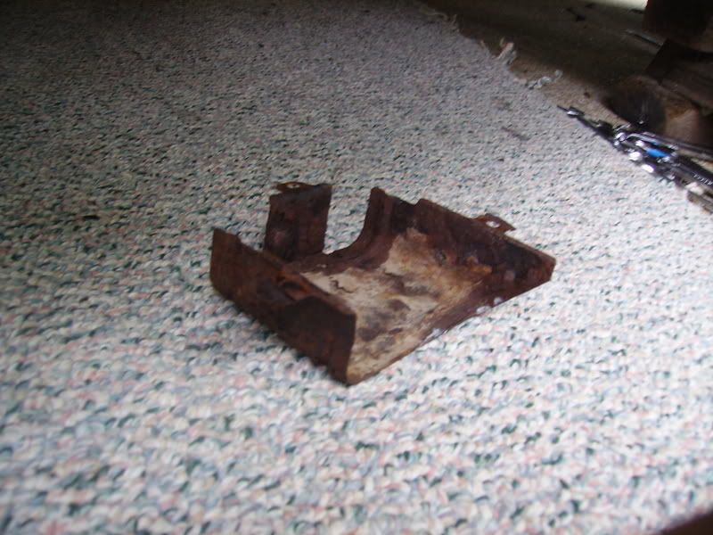

Here is the guard you will have to remove. I didn't reinstall the rear screw because it was a bitch, i put the sides on and called it good.

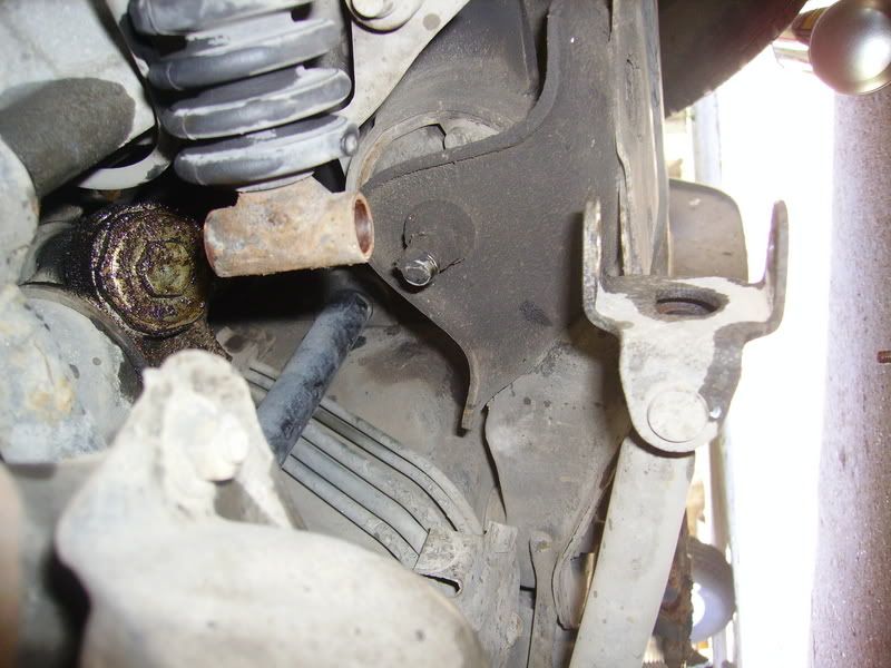

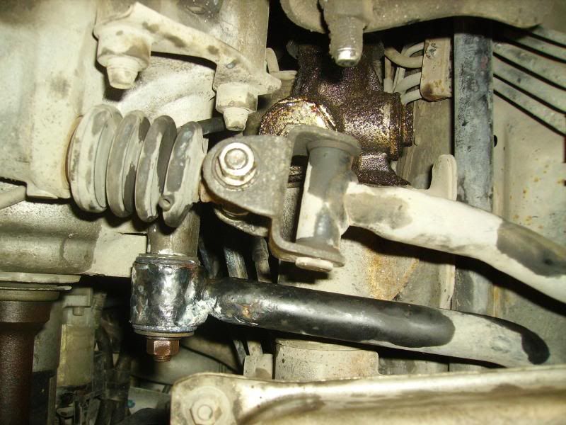

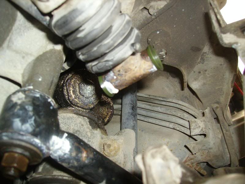

Time to switch to the front, the easier of the two if ya ask me.

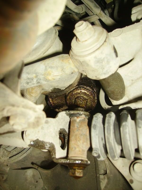

you want the vertical bolt here...
Do the same thing as on the rear.

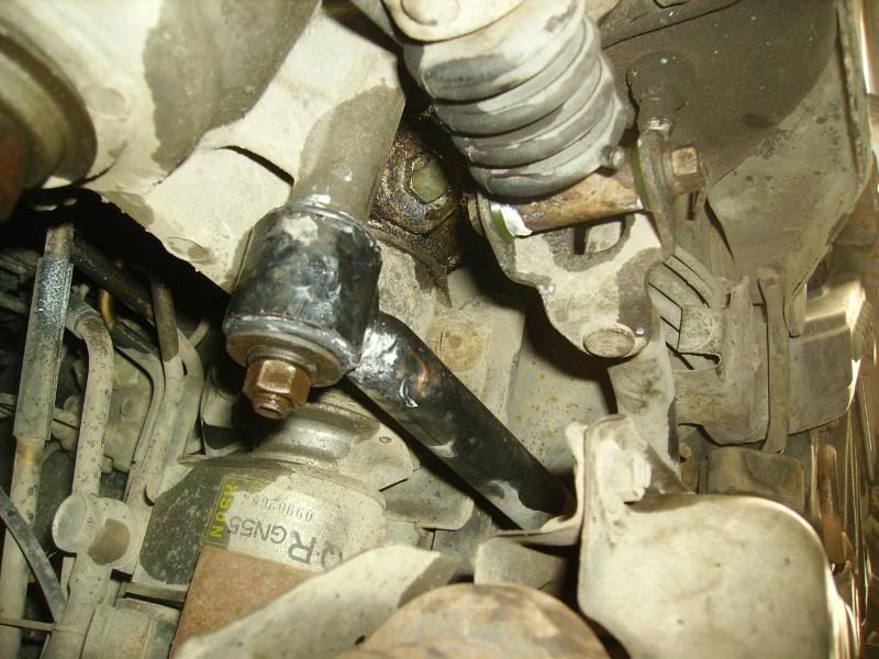

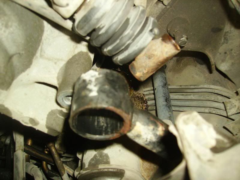

Now the big one...
Undo the one bolt that goes into the bushing. It is longer than the others but comes out pretty quick
I cut the front edge off of the bushing which allowed it to slide right out. Pull the metal sleeve out first, it makes things MUCH easier, and needs to be re-used.
Push the new pushing in THEN the metal sleeve, grease it all of course.
Put in the bolt and tighten it all down.
