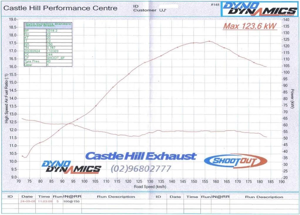

Well I got the car tuned today and great news, it didnt blow up or nearly blow up like last time :D:tup:.
Made 123kwatw at 6psi as silly me didnt set the boost controller to 8 before I got on the dyno. The tuner said that my turbo was way too small as well so start saving for a new one :). Thinking go Gt30 (his advice) or maybe a Turbonetics unit as they are quite alot cheaper then the Garetts and look pretty decent. Also one sucky thing is that my rear exhaust mani gasket blew while on the dyno, and there is smoke everywhere in the engine bay and it really gets into the cabin while im driving as well. Wont be able to get that fixed till next next weekend but oh well, lets just hope it doesnt kill me :).
Overall I'm disappointed with the numbers I suppose because it is less then I expected but really I don't care. The car frieken fly's now and drives so much smoother and we will see how much fuel economy I got back :D. Sux that I have to do a long road trip tomorrow to Terrigal with exhaust gases in the cabin though.

Thanks Jmoore, but what do you think of the dyno??
Also Ill tell you what, ive driven some "170kw" cars and I can see know how numbers can get bullshitted around real easy. This is <130, and a shit load quicker then some "170" or so cars.

I would love to see what sort of torque numbers your car is making. The graphs looks beautifully smooth. what sort of A/F ratios are you seeing at idle and cruise? 12.7 seems awfully low.

I have no idea what the numbers are like there as I wasnt in the room while it was being tuned and my wideband is not exactly accurate at the moment due to a bad ground.

Good to see you got it done, all of us having a go about the black smoke on the cruise, stir you into action ?
I would have thought it would be more like 140 just by how it went on the road.
I was following you and had to power shift to keep up. Mind you I've never put the 89 on a Dyno, So I have no idea what its good for.
Maybe we should do a dyno day....though I want to wait until I finis the turbo swap...could do a before and after tho.
