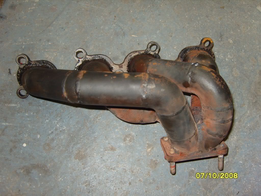

I have an EVO manifold with an adapter plate welded to it....I'll see if I can post up some pics...I was originally going to make a bolted adapter plate (cos I want to make my engine look stock with heat shields and everything) but Jesiotrot bought a project FE3 engine and sold me the manifold with the adapter plate already welded on.
There is pics of it in my photobucket account, the port holes line up nicely -
I'll upload some better pics of how good they line up.
5
Couple more pics -
And this is a custom made one that came with another FE i bought, no idea who made it -
