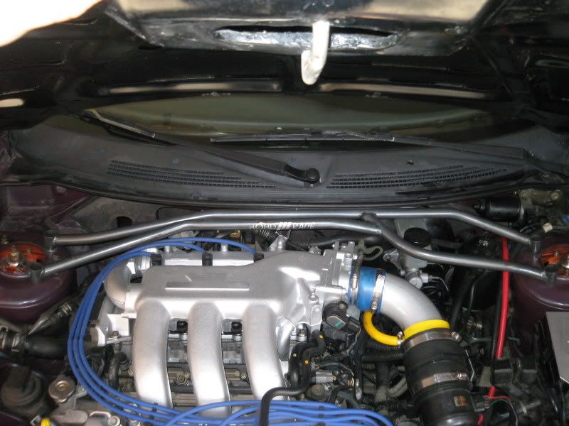

Here are a couple more pics of a RRE bar. This design seems to be different than most of the other RRE bars out there. I bought it off someone local so I do not know the history of the bar.
Though the passenger side does not have a connection bar/cross bar welded to it . This allows some flex for discrepencies amongst cars I would assume. I would recommend adding a connection to that side though if you are going to use this design.
Hope this helps.

I agree with the last statement. ZE Power MX6, see if the guys at RRE can make a true mounting plate that has holes for all 4 studs. The setup I have and the other bar pictured has a single point set up to 2 of the 4 bolts and is not as effective as a plate style mount.

That should be doable, I'll talk to Mike about that. Basically is just a metal plate welded on top of the current RRE bar.
That's right, the person I bought my bar from had an mx6 and it didn't fit. The reason he sold it to me. What kind of difference is there between the Probe and MX6? Wouldn't the strut towers be exactly the same dimensions?
Shit, if you guys get the plate style I want in, but if the mx6 and probe have to have different bars then cannot. Maybe I should just get someone to weld in a plate on my RRE bar.
