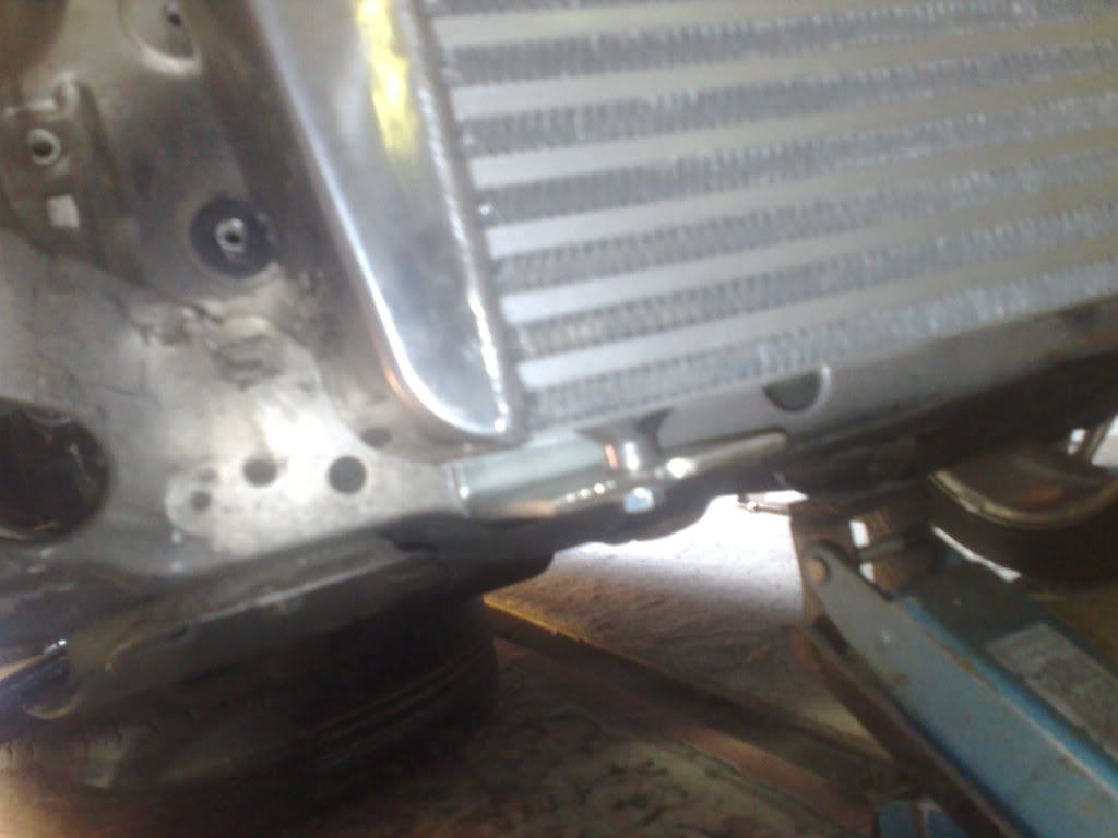

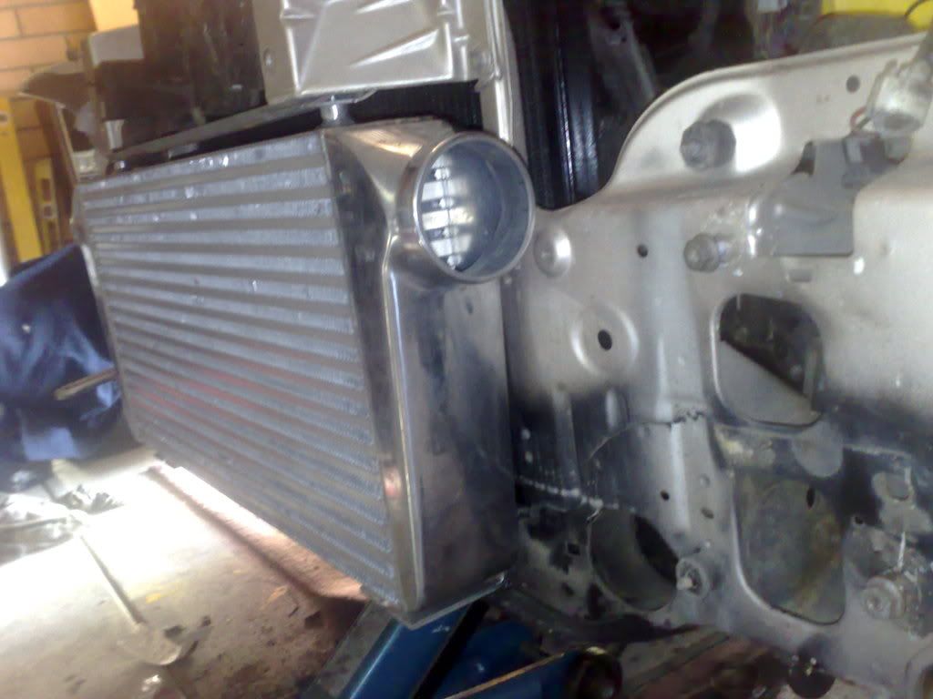

i used a cheap one like the super cheap ones that were out
get some L brackets from bunnings, there was already one hole for the bracket so i only had to drill one more and it sits tight as
i only had to take a little piece of the back of the bumper, and it fits nice
then just get some radiator hoses to make some quick angles, i have left mine as is for now, then just take it off and get someone to make it up in something nice

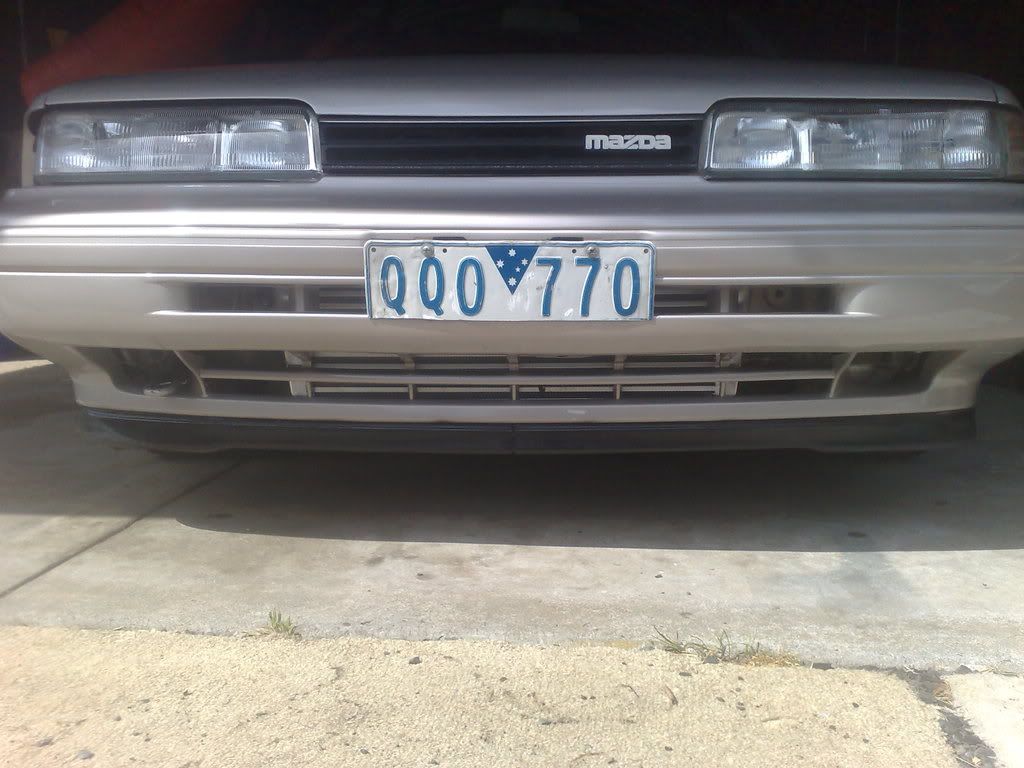

sweet as what were measurements for that one? looks really good and has a good fit ay
that is a 600 x 300 x 75 cooler.
I dunno Scott, looking at the pics it looks like it's 600 x 300 x 76 :p
The one that I have in my car is approx. 600 x 300 x 50, and like an idiot, I had my a/c taken out :/ My brothers car has a x 76 one, it was a nice fit. You have to do some Mr Squiggle work with the pipes to curve them back into the engine bay, but it's well worth the work. It's not too bad to do overall.

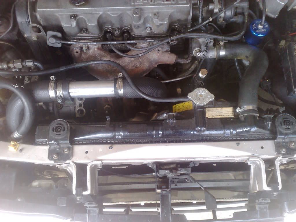

when i go to fit it all up what are the things ill have to remove from the front to fit it on? Like i know the old intercooler will have to go but anything else?
I disconnected the air con, it didnt work anyway. I think people have left it in aswell.

if you want a nice fit with no bumper cutting i suggest doing as everyone else has and mount the intercooler upside down. wish i had of told the shop to do it with mine, would of saved me cutting shit.
24" x 12" x 3" is close enough.
12"= 1 foot = 305mm
