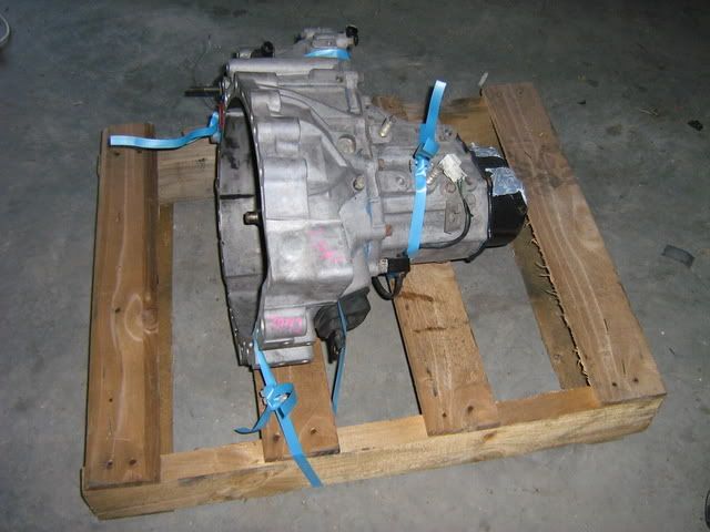

Gearbox got here today looks nice and clean, hopefully i will learn my lesson about giving it so much hell but i dout it i have always been pretty hard on the car
