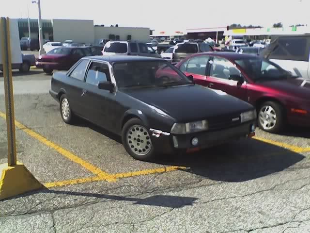

Here's what mine looks like. There has been some undesirable stuff done to it by the previous owner, such as there was a wing, horrible paint job, front bumper removal and fog light installation, the dash pad is tore up, and they installed a stereo without the dash kit. Its some pretty moronic stuff. There's absolutely no rust and it only has 86,000 miles. Here's some crappy pics.

That's very similar to what is in mine. (as you can tell by the pics I posted)
Ahh, I can tell by the picture yours is the multi point version (different intake manifold and different air box) with the vane type air flow meter.

Thanks for the info, It was originally silver. I can tell by what was not painted in the engine bay, sad thing is it probably looked great that color and I doubt it was worse looking than what it got. Oh well it looks kinda tough, in a mad max way. The guy who did the more recent work to it must've been very inexperienced or a lunatic.
