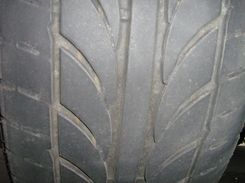

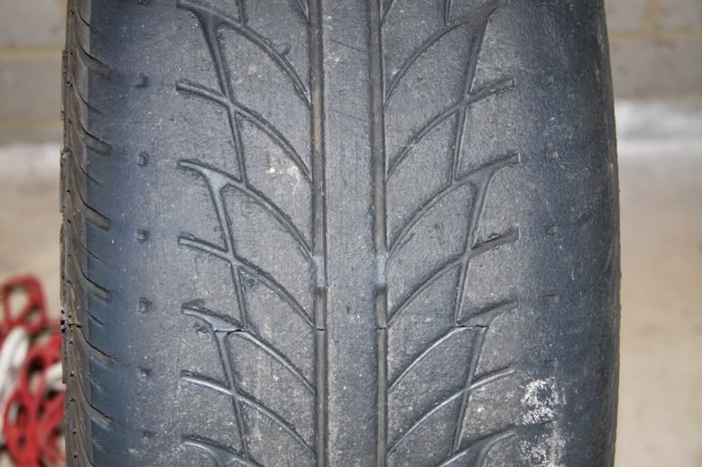

I should show you some pics of the tyres I raced on for the 2nd half of last year....
actually.
lol
im bored... back in 5 with pics
raced/daily drove. racing only like 10km a month though.
new in june, havent used them since last year.
cornering = hard on tyres!!!
LHS of pic would be inside of wheel.
Looks like you need alot more work on your suspension setup.
It's pretty good but I've never had that evenness. It's always been harsh to the inside and even all the way out till about 5mm of the edge, then it's abusive.
but I was doing normal street tyres every 9months - with street use.
Mind you of course my suspension is rebuilt all round and custom alignment. I for go the tyre wear for max grip.
But I have never checked the Wagons settings since I put it all togeather I just set it up exactly the same specs as all south and mid european Wagons were setup.
Add max factory camber V Aus spec 0
So far it's all good on crappy kumho's which do well for plain steet tyre. which is perfect considering the use it gets or is that Abuse.
