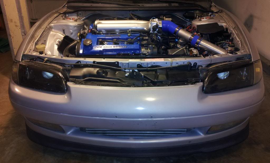

Well I figure it's about time I start my build thread now that the build is almost complete. I'll
start off by saying this past year has been quite the year for my most expensive hobby lol
Last October my car was stolen and found used and abused. Now, over a year later after a
lot of waiting on everything and consistent problems, my car will once rise again bigger, faster
and stronger! Goals are 350-400hp daily tune and next year a dyno day to see what she can
really do! On to the details/pictures. All comments and questions welcome!

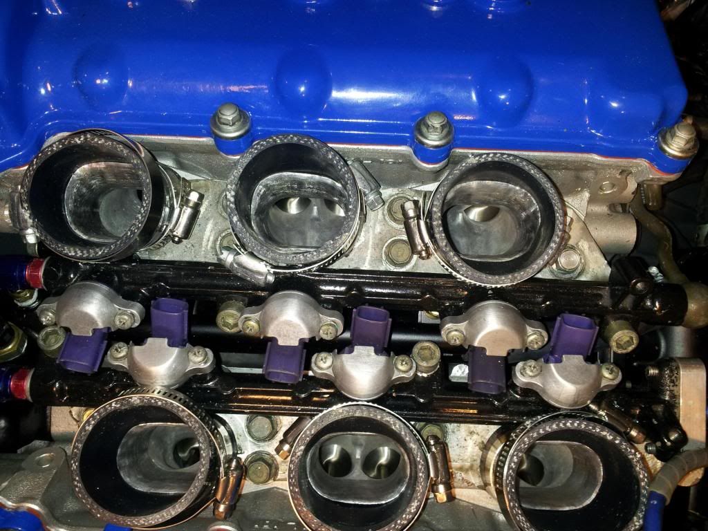

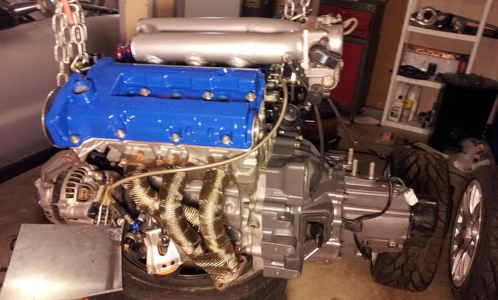

Block -
2.8L @ 9.6:1 (bored .030/stroked/oil galleys opened up/oil squirters blocked)
Cunningham rods
JE pistons w/floating pins
Hastings rings
new OEM oil pump shimmed and internals treated
Heads -
Aggressive P&P
Ferrea valvetrain (valves +1 mm OS, titanium dual springs/keepers/retainers)
Delta cams
ARP studs
custom head gaskets
custom Intake manifold (built by polarexpress)
Nissan 800cc injectors
Aermotive AFPR
Walbro 255
King6 manual timing belt tensioner
King6 solid motor mounts all around

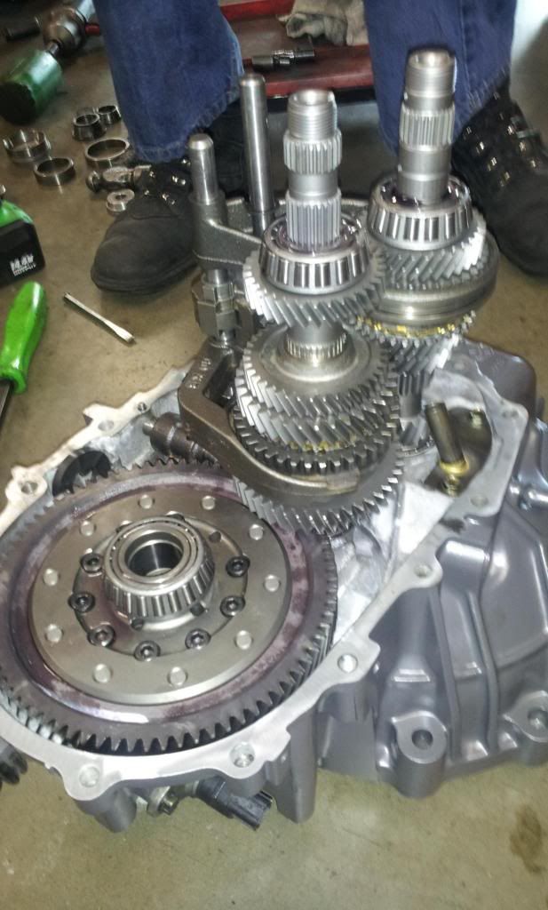

Transmission -
MFactory LSD
Treated gears/shafts
syncros modified
case powdercoated

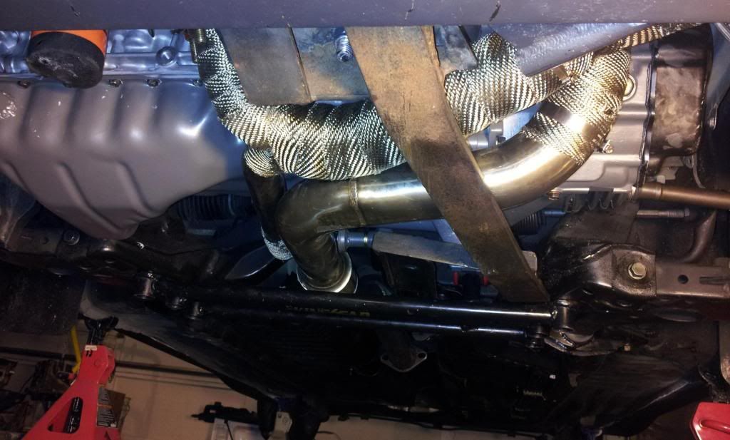

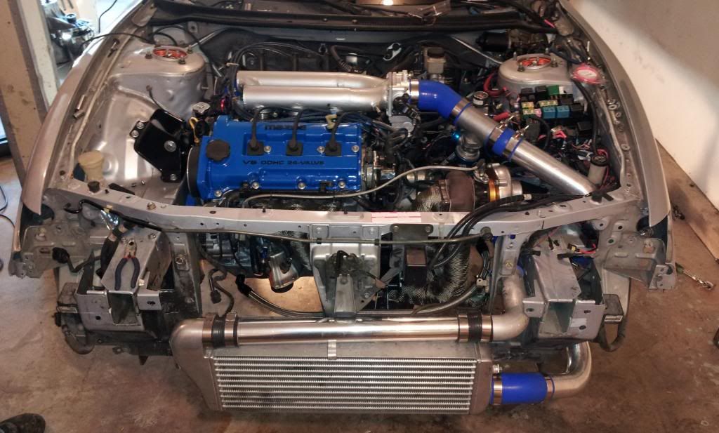

Turbo setup -
Turbonetics 60-1 (T3/T4, .63 Turbine, 57 trim compressor, Polished Compressor Housing, rebuilt by Zach)
Greddy V-spec intercooler (piping 2.25 in, 2.5 out)
Tial 38mm wastegate
knock off BOV (for now)
MSD coil w/ZE disty (HEI mod)
Megasquirt (MS1 v2.2)

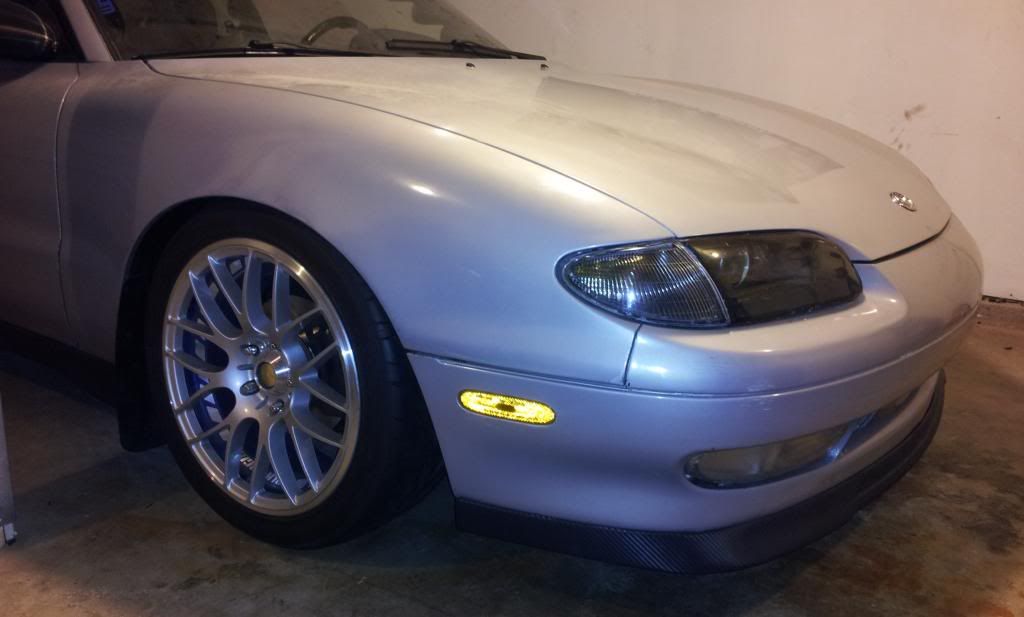

Exterior -
CF Mazdaspeed front lip
CF Mazdaspeed side skirts
CF Camaro rear lip
CF Mirrors
M edition tails
custom headlights with Audi RS6 projectors (built by Stealth)
DDM 6k 55w HID
Volk Winning F-Zero 17x8
BFGoodrich Gforce T/A KDW 2
H&R wheel spacers/studs (15mm rear/5mm front)

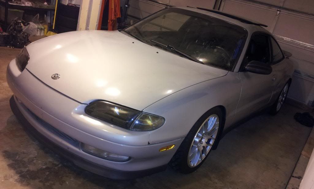

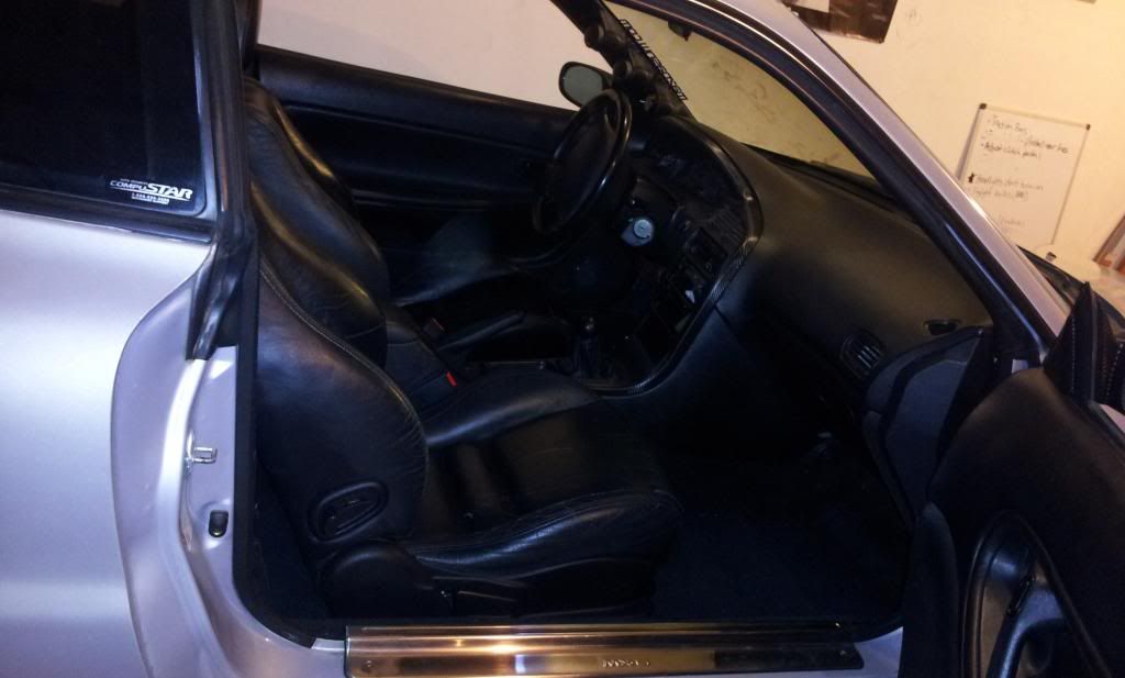

These were the last 2 pictures taken before she was stolen.
As she sits (still...)

:tup: :tup: for proper intercooler routing :)
everything looks awesome. i like that the valve covers match the couplers.

Yeah, that Greddy intercooler IS pretty nice isn't it ;) Wish I could get my wiring expert over here. Dude is super hard to get over here. I'm thinking the 94 626 harness isn't compatible with the 93 Mx6 harness. Anyone have any input on this? The fuse box is different between the 2 but every plug is the same. Wish there were more mx6's in the junkyards. And Deedz, I don't need more pictures...I need more videos!!!
