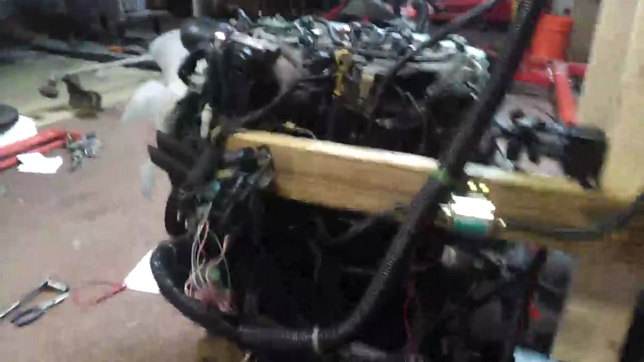

Bypass oil filters - why bother
I had been looking into the reason behind my 626 diesel having two oil filters, one is a "bypass" filter.
What is the reason behind it ? here is a good explanation : By-Pass Oil Filtration
For me I need to consider shifting the arrangement as I want to fit a turbo to my engine, and it would sit where the current full flow filter sits. I may need to consider a relocation kit as getting the factory parts for an RF-T or RF-CX are going to be next to impossible.
the arrangement has changed over the years, the early GCs had the bypass filter on the chassis rail. Later they attached it to the block. and by 1987 the bypass oil filter had been ditched entirely to be replaced with a "combined" oil filter...maybe this had something to do with space.
Here is a pic of where my bypass oil filter sits :
Here is where its sits on an RF-CX, there is only 1 its a combined type :
And here is where it is on an R2 :
Once again must be a combined type filter as there is only 1.
I'll add some of the other cars oil filter positions soon.

I figured I would sign up on here and post what information I have on the Mazda RF diesel I picked up back in April.
I purchased the engine from this vendor: Mazda Bongo Brawny 2 0L Turbo Diesel Engine Transmission Harness ECU JDM RF | eBay
The transaction was smooth and I was able to get it for slightly less than they are asking on eBay because I went to their warehouse and dealt in cash. Unfortunately, they were not very helpful when it came to obtaining information, but that's okay since I didn't really expect them to know anything more than what they posted in their eBay ad.
I was able to backtrack the PN on my ECM and found that it is from either a 2004 or 2005 Mazda Bongo or possibly a Nissan Vanette. From what I can tell this particular engine/transmission configuration was only found in the 2003+ Mazda Bongo. As a front engine, longitudinal mount RWD (or 4WD), Mazda refers to it as the RF-CDT. This engine is also found in many passenger vehicles in Europe (and possibly Japan), but it is referred to as the MZR-CD (front engine, transverse mound FWD). Mechanically the engine is just about identical between the RF-CDT and MZR-CD, but the electronics are quite different. For one, they do not share the same ECM. The front-wheel-drive passenger vehicles have a sentry key immobilizer built into the ECM, but the RF-CDT I have does not (thank god). There are also some other subtle differences in the electronics that I have found from the service manuals I have been able to obtain for the European passenger cars that have this motor (Mazda 3, 6, MPV).
I searched high and low for a service manual for the RF-CDT and ultimately was only able to get my hands on a Russian manual, which I am in the process of translating. I have been able to get many of the engine wiring diagrams translated and sorted out and I have the engine up and running on a test stand. It's a drive-by-wire engine so I have no control over engine RPM.
Here are all of the pictures I have:
Video of the engine running:
