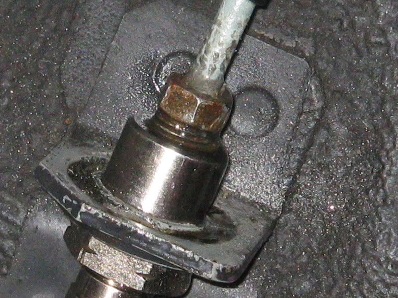

Hey guys, here are some pics to further illustrate my dilema:
So it turns out that Porterfield built my lines with the wrong fitting, it is too deep and/or possibly the inlet hole to large/not the right angle flare(wtf). So I just ordered some tried and true Goodrich lines that should fit no problem. I have a couple used Goodrich lines and the hardline adapter looks identical to the stock one(as you can see in the pic), seems like a good quality part. Fuck Porterfield lines and XRP fittings.

Sauer, my lines are pretty good, no rust or anything. I will see if they are ok with the Goodrich lines. I did kind of use a little muscle on one of the lines to see if that was the problem, but now I realize that the flare never even really sealed against the fitting cup(which is the cause of the leak) so my flares should be good. You are able to wobble and move the fitting when it is attached to the hardline, indicating a massive amount of play. I think the reason it got harder to tighten is because of the deepness of the fitting(the stock ones are pretty shallow) and the corrision on the line nut.
