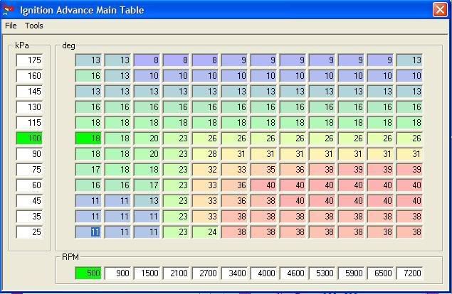

Ok well this is the tune that the MS has on it atm, I just fetched it. Btw, by no means should anyone just copy this and go thrashing, it will kill your engine :). Im just posting this up to get some opinions on whether this tune is reasonable, just so that I can rule it out as a culprit in my engine blowing. I intend on using this tune (very close to it) when I get the ZE running again (hopefully with the 10:1 pistons still, if not my spare DE internals depending on where the damage is).
I can provide the MSQ file by email to anyone who wants to have a closer look.
Need anything else to get the big picture, just ask :).

would prefer to see a datalog'd run instead.
your ve map doesnt tell much when there are so many variations of setups that can be run.
I 100% agree with King, but aside from that in the ignition one, the 2700x25kpa cell seems out of place, and the transition from your idle region to normal seems very sharp. Mostly they should be smooth, 3d views would help show that pretty well.
What is your AFR/Lambda target curve like? That is a good one to look at on a screen and go yes/no. Then you just change the "ve" to make the AFR match the target as best you can.
Fred.

Have you ever datalogged? Also made a AFR target table?
shoot I run a datalog almost everytime I drive the car, you can alwase go back and see whats going on. To hard to keep moniter things while driving, atleast for me.. bad at multi tasking...
I dont know much about tuneing MS, Ive used the analzyer to dial in alot of areas... and so far everything has been running pretty much dead on
Just noticed when screen capturing those, my most recent tune's are setup with afr bins I got from strealth (not the ones I pictured) That explains somethings.....
