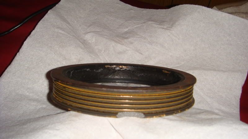

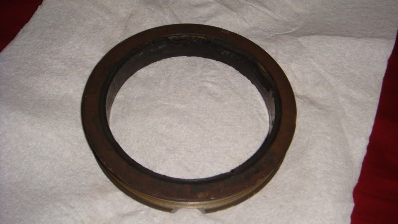

i never thought this could happen. well, i guess theres a first time for everything. ill let you take a look for yourself.
now, what should i do about this? it's the outer half of the crank pulley. should i get an oem replacement or should i go for a performance one? i was looking into the unorthodox racing pulley but it's so freaking expensive. then i saw the obx one. it's about $75 shipped on ebay. anyone have any ideas? thoughts? comments? opinions? lets hear em!!

Don't get an underdrive. They don't have the harmonic damping capabilities of the stock piece. Supposedly an engine gets killed in relatively short order without the harmonic damping.
Just snag a stock piece. :tup:

damn. ive been doing my research all day on the pulley. my friend's warehouse was closed all weekend so i couldnt get a price on a oem replacement. also, i also read that it was really difficult to replace it without an impact gun. i was thinking of taking it to a shop to get it replaced. and another thing that makes me nervous is that i also read that if it wasnt installed properly, i can screw up the timing. bah. i dont think its worth the trouble...

What... doing it yourself? Have some confidence! Sure you could screw up your timing. Driving a car, you could drive over a guard rail and cause mass havoc, but that doesn't mean you do it! I've taken apart the t-belt, camshafts, lifters three times now. Just read the haynes. Besides, it's not even really a problem if you screw up your timing. You just set it right again..
The bolt on mine was rusty as hell, and a breaker bar had no problem getting it off. Just put the car in 5th gear and have someone stand on the brake pedal. The engine won't turn and the breaker bar will make quick work of the bolt. I didn't even need a puller. I just used my hands and pulled hard while I wiggled back and forth.

picked up the part today!! $73 woot! made by DORMAN. OE replacement. so fresh and so clean clean!!
