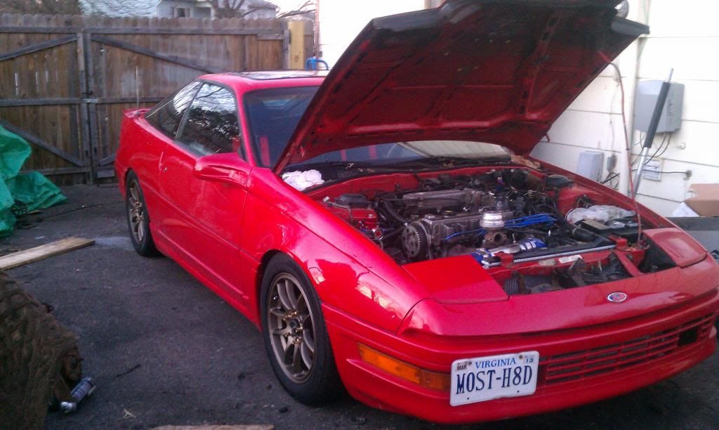

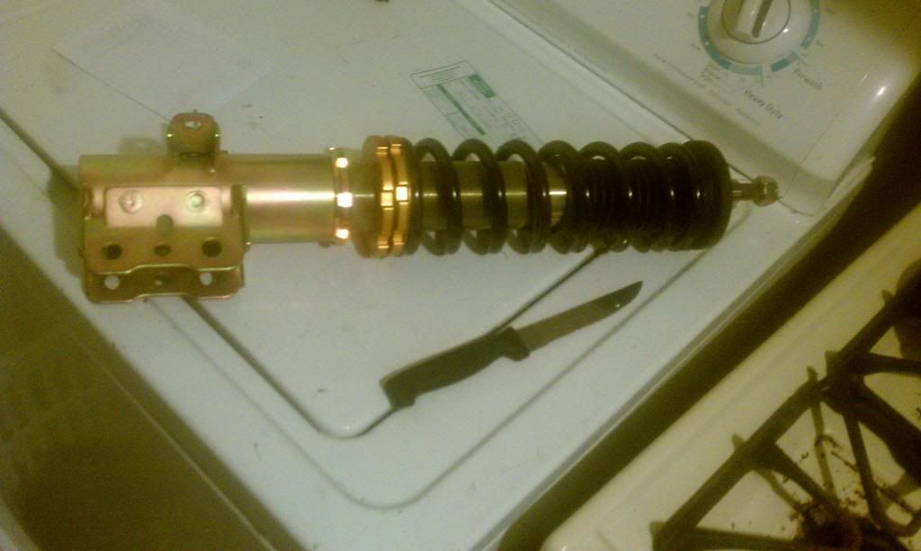

I bought one of this coilover for the probe, it was listed for 93-97gt, why not.
the install on the 1st gen went smoothly. using 1st gen strut top hat.
front strut

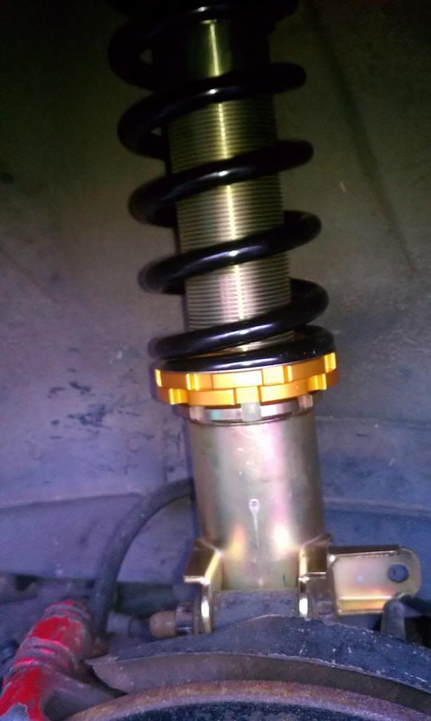

back strut
back strut installed

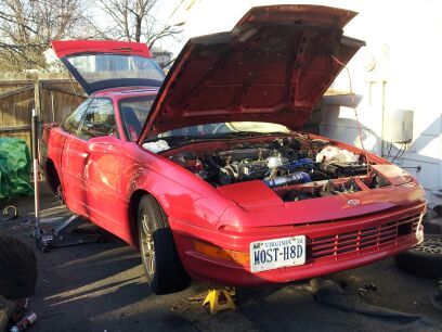

front strut complete
complete
havent put the car back on ground yet, still waiting for the na clutch slave cylinder, i swap all gt tranny/axle/spindle.linkage for lx/gl parts. need to replace slave cylinder and the car will be on all 4 wheel

Looks good Phil. Are you trying to make your car look like mine,lol.
yes, isaac.. Im trying really hard,lol.. just trying to get a better adjustable suspension for the price. I saw your stance with the ksport.. so i bought the yonaka.

Yes you use the stock upper strut mounts and bearings.
Keep in mind the Automatic front strut mounts and bearings are different than 5speed and might not work. the good news for automatic drivers is that Gabriel upper front mounts are on closeout sale at Rockauto for $5.81 US each.
The rear strut mounts are the same on auto and 5speed models without 4 wheel steering (useless innovation).
