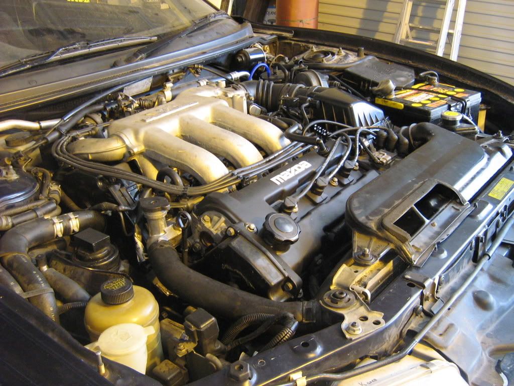

So after a very long 4 weeks it's all done so i thought i would share it with MX6.com

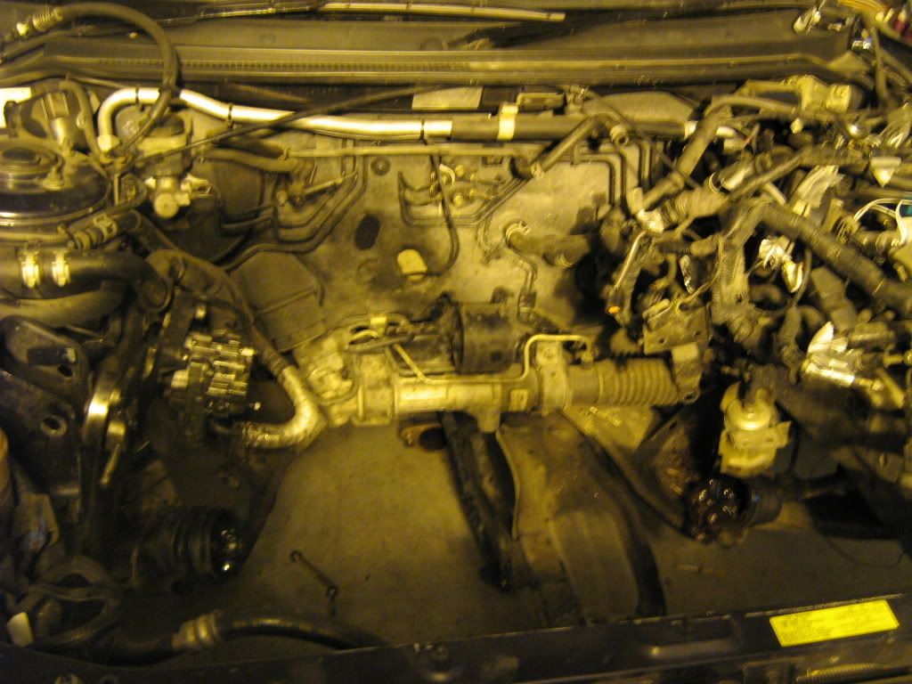

The beggining, wheels and bonnet off
One of the old plug leads, when the waterpmp failed the motor got hot enough to melt the plug leads to the spark plugs

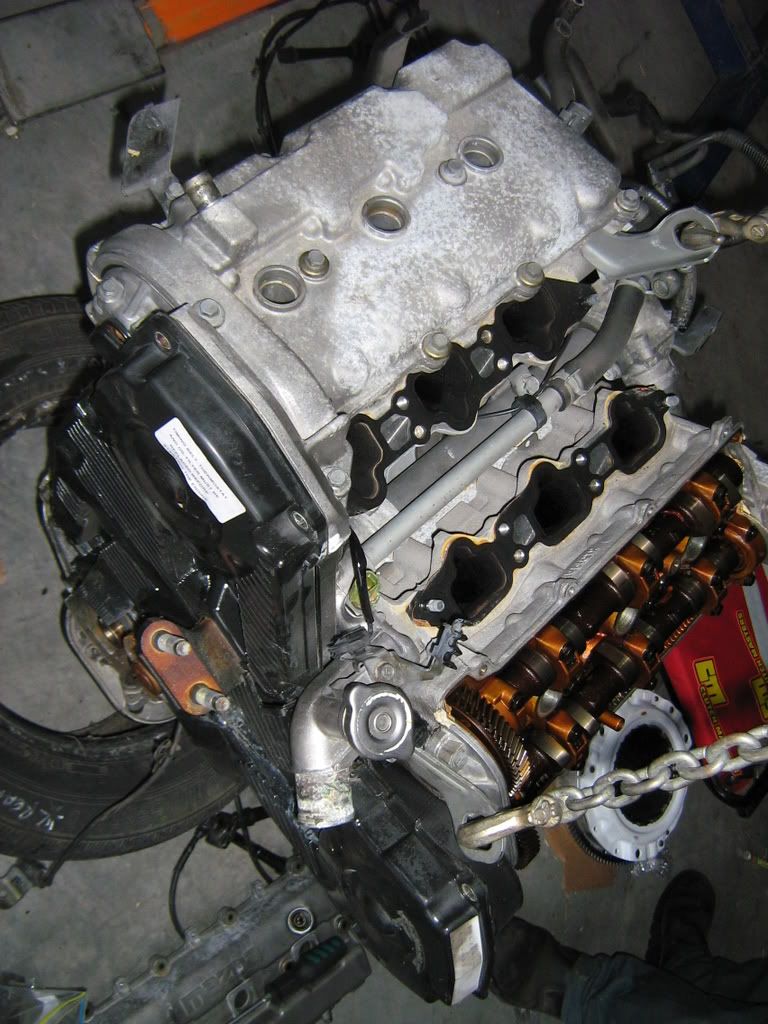

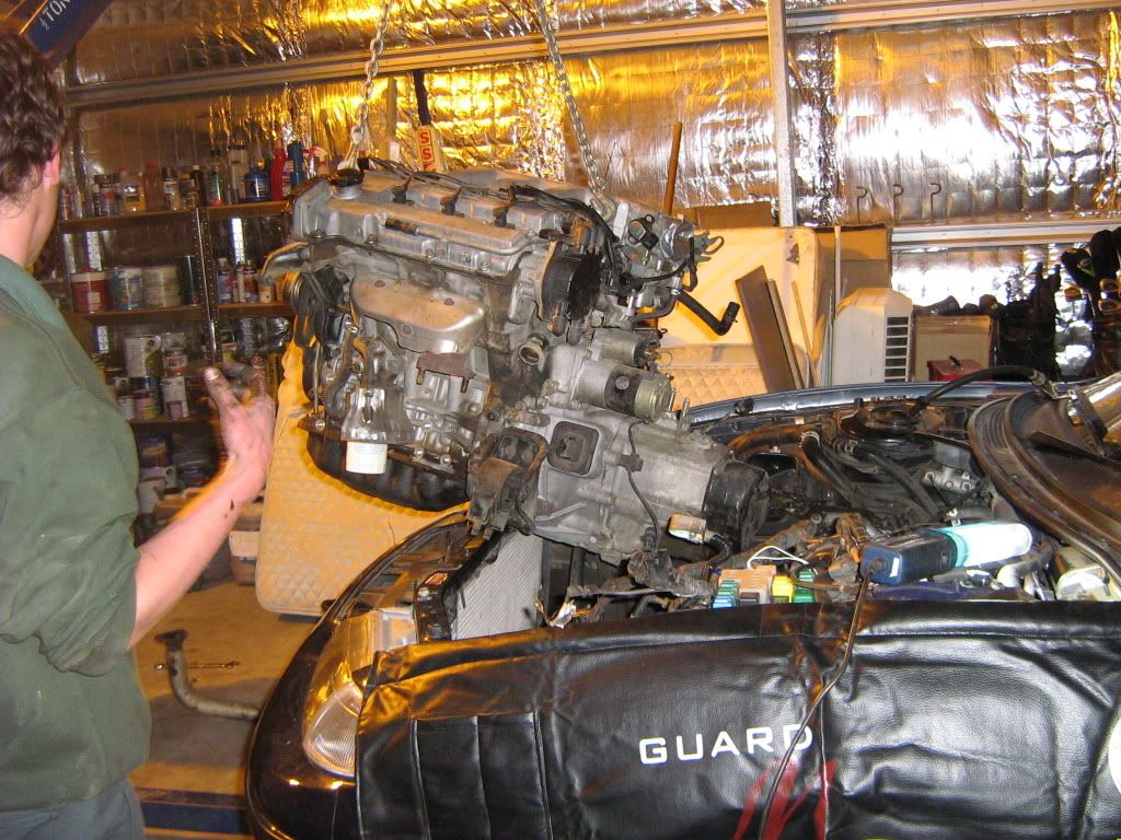

Old motor out

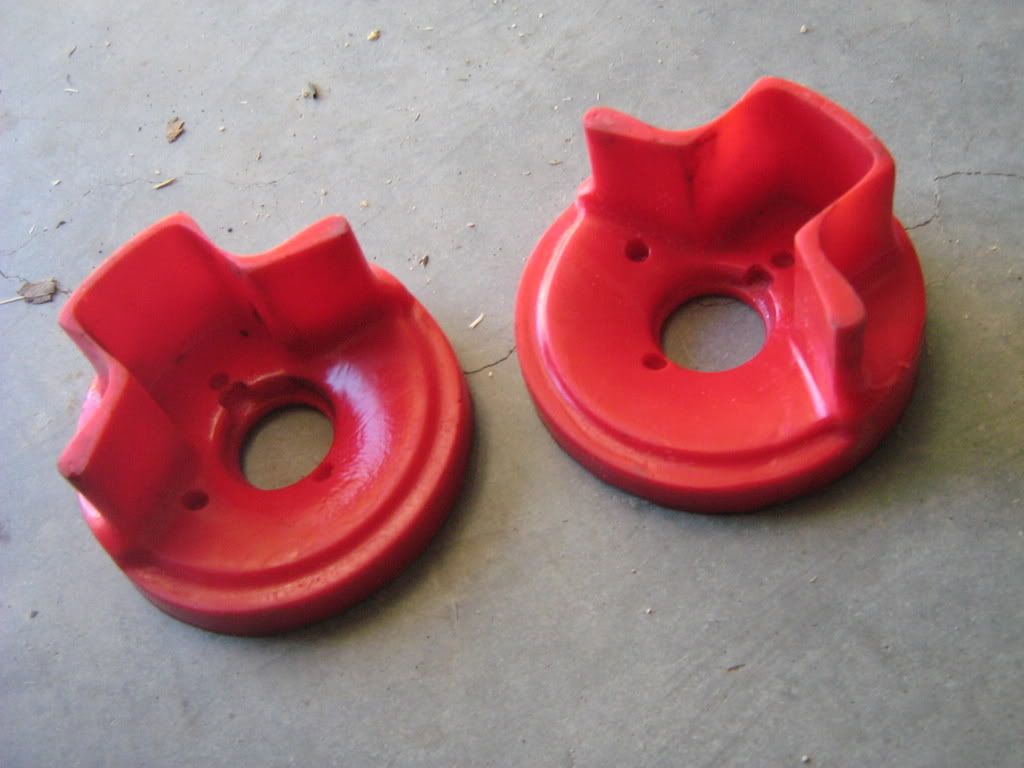

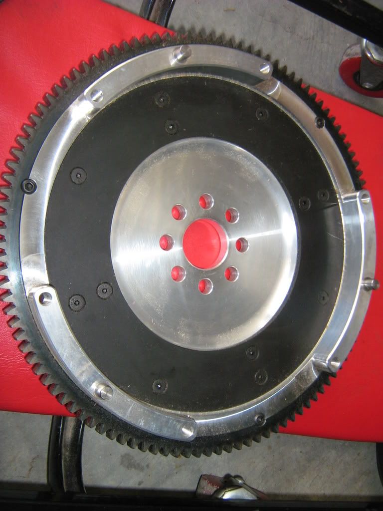

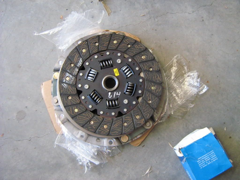

New flywheel and engine mount inserts

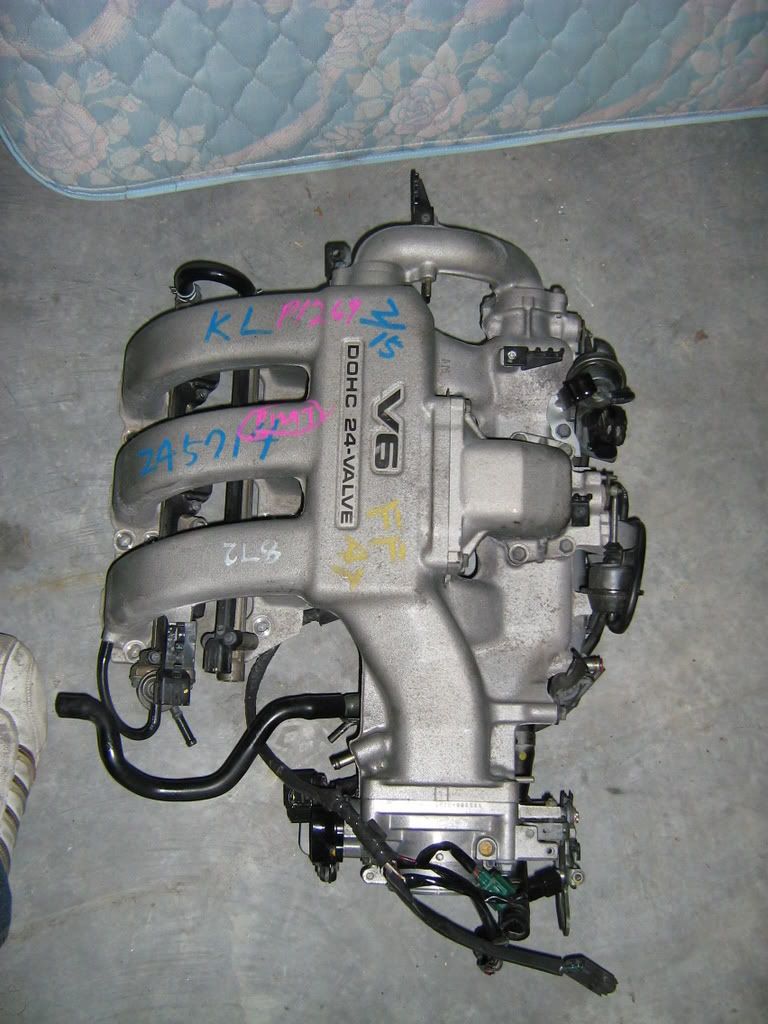

ZE finally got here

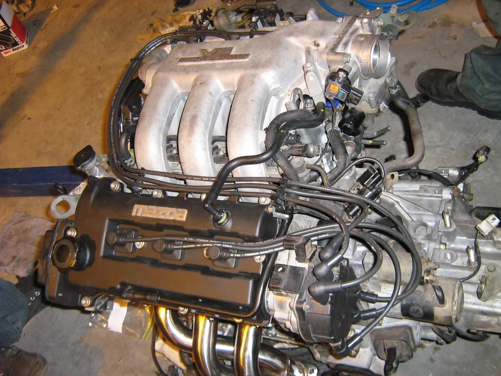

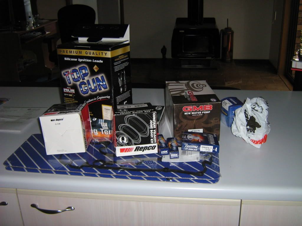

This dosnt look like $1000 worth of parts but it is

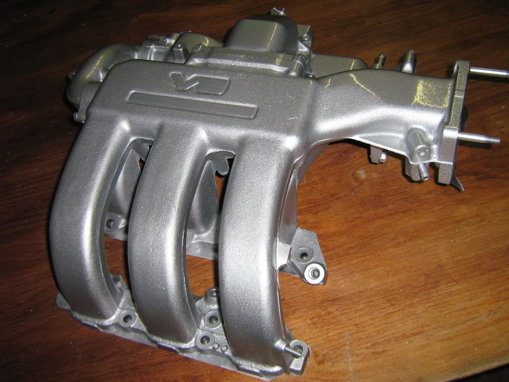

Ready to go in with the DE IM

And now it is all done i can't wait for all the problems to start but it is going strong now i had a problem getiing it to idle but thats because i didnt connect the rear vc vent up so it was sucking lots of air but i fixed that and now it's sweet ;)

if you dont mind, could you write down a list of items & prices you got before you installed the ZE.. im looking to do the same thing around december! so any help you give me would be great =]
ZE = $1500
waterpump $170, plug leads $220, VC gaskets $50, timing kit $485, plugs $120, CV boots $80 and thermostat $35. This is retail price from repco, i work at repco so i got it all for $511 i get almost cost price

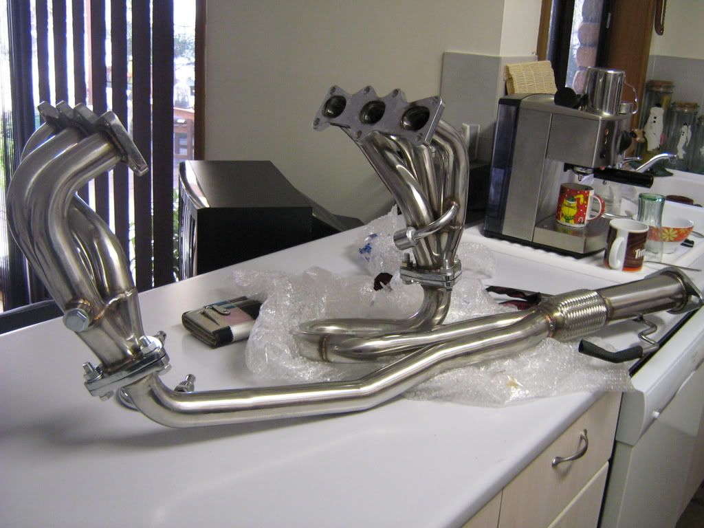

Headers $272
clutch flywheel and mount inserts was about $800 all up
Pheno spacers $150 but they are a waste of money my IM still gets just as hot

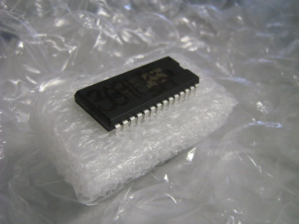

Probinator chip $65
Then there is stuff like motor oil, gearbox oil, filters and the CAI and all that shit

Do you have a metal elbow for between the IM and VAF? That corrugated hose is hella lame.
752 Posts
Discussion Starter · #14 ·
The plugs are NGK iridium and they are $20 each it's bullshit i know and i couldnt get a bend tight enought to go from the TB to the VAF so i had to use that one and i know it looks shit :(
YOOOOOOOO120forplugsYournutz.

By the way cf_z the clutchmaster clutch is very nice it's soooooo smooth i was expecting it to be a bit of a pig but it isnt at all but i will say i will never buy anything from RR-racing ever again, Rafi forgot to send me a clutch line but made up some bullshit excuse, i get the feeling because im in Aus he knows there isnt much i can do :mad::tdown::tdown::tdown: not very happy about it
